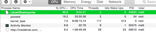

The new v2.1.2 does this on my MacBook Pro, too.
Sample file and screen shot attached
++matt
- 2015-Oct-10-v2.1.2-Sample of LibreOfficeImporter.zip
- (39.05 KiB) Downloaded 1221 times
- Libre office screenshot.png (40.46 KiB) Viewed 45613 times

Thank you for the sample Matt. We are investigating the issue.
