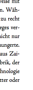

In the example attached below one can see two normal hyphens (automatic hyphenation) and a soft hyphen which was necessary in that position to avoid a wrong hyphenation (German hyphenation ist still not reliable at all). This third hyphen is obviously taken from another font. The text is Adobe Jenson but this hyphen not. Is there a way to change it also to Adobe Jenson?
If a select the wrong hyphen, the entry AJenson in the font menu is red.

- Soft hyphenation (third hyphen) with wrong font
- Bildschirmfoto 2015-10-27 um 18.20.39.png (16.06 KiB) Viewed 16943 times

Yes, the red AJenson means another font is being substituted. That's weird, because Adobe Jenson Pro includes soft-hyphens among its glyphs, so why is a substitute being called for? I have no idea.
But I'd simply try highlighting that soft-hyphen, maybe including a bit of the surrounding text, then clicking in the font menu and deliberately choosing Adobe Jenson Pro from that. It should change, and the font box should turn black.
But I'll leave it to others to try to explain why an unnecessary font substitution is taking place.

Already tried it. If I select the surrounding the entry in the font menu stays red no matter what font name I enterxiamenese wrote: But I'd simply try highlighting that soft-hyphen, maybe including a bit of the surrounding text, then clicking in the font menu and deliberately choosing Adobe Jenson Pro from that. It should change, and the font box should turn black.

I have Adobe Jenson Pro and it does include the soft hyphen (I checked using the "Show Emoji and Symbols" in the flag menu) but if you have an old version of Adobe Jenson maybe that doesn't. Mind you, I can't remember which App came with the font.useeger wrote:……I don't know wether the Soft-hyphen glyph is contained in the font. It's an old one, perhaps not (?)
Maybe I should try another font ... but Adobe Jenson is soooo beautiful.
Re: Soft Hyphen
Good hint. I checked it too and saw that my old Jenson does not have a soft hyphen. OK, now I understand.xiamenese wrote:I checked using the "Show Emoji and Symbols" in the flag menu
