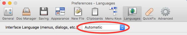

It's easy to change the language used in Nisus Writer's interface (menus, dialogs, etc).
You don't need a special version, as the single app includes all languages. Just follow these steps:
2. Switch to the Languages pane.
3. At the top, change the "Interface Language" setting.
4. Quit and relaunch Nisus Writer.
The following localizations are available:
