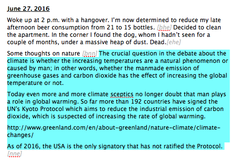

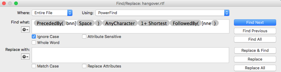

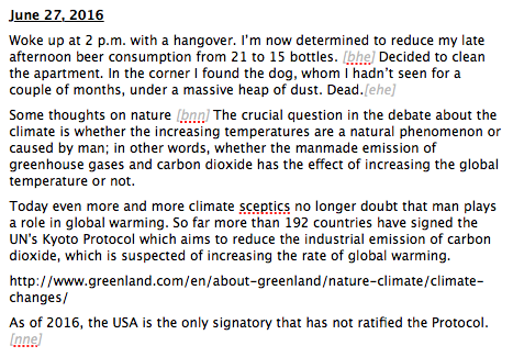

It seems you are trying to use NWP as a database, which may not be a very good idea. However, it’s hard for us to say for sure, because we don’t know exactly how your document looks like and why you are using paragraph styles to tag different types of subject matter instead of using, for example, inline tags in brackets, which won’t slow down performance. You could, for example, tag your nature notes with [bnn] and [nne] respectively, where “b” stands for “the beginning of a nature note” and “e” for “the end of a nature note”.
Inline tagging would enable you to quickly find all your nature notes; and with Find All plus Copy you could easily extract all these notes and paste them into a separate document for further editing.
The screenshot shows how to search for all nature notes: [bhe] = beginning household events
[ehe] = household events end

The suggestion by Þorvarður that inline tags might be a useful alternative is also a good one. They may well speed things up, as well as offer a range of Find enhancements. However, Nisus Writer offers no way of toggling the visibility of such tags for “ordinary” reading — at least not in a way that invisible tags will survive relaunch of the application. Which is why the “prettiness” question is important. If tags are used and the document still needs to read normally, I would seriously consider migrating the document to BBEdit and recasting it as an HTML document. I would also create a CSS document in BBEdit, then view the HTML document in a Web browser. Everything could be made as pretty as one wanted. Incorporation of images would be easier, too. The Table of Contents would be a set of hyperlinks. The Web browser’s Find command would give rudimentary search capability, but for serious work (ie, using regular expressions and searching through multiple folders, whether open or not) one could use BBEdit’s sophisticated Find/Replace mechanism. Scripts of various sorts could be used for certain purposes. Nisus Writer can be used to do all this — in fact, I have used it extensively for such work — but I find the workflow for Web development is more seamless with BBEdit. A word of caution: I would first check with Bare Bones Software about any filesize limitations the program might have.
So there are other solutions, depending on David’s precise needs. But I reiterate: it is better to try to solve the original problem before taking any drastic measures!
The way I see it, we probably need an opinion from Nisus regarding David’s original problem; viz, the aberrant TOC behavior and long delay on opening his long document. They may have a solution that saves him from a major redesign exercise. It would also be of interest to others thinking of embarking on such a major project.
Having said that, there is no reason why Nisus Writer Pro cannot be used as a database. Indeed, I have done so myself when faced with the deplorable state of database software for the Mac. (I used to like working with FileMaker Pro, but I could not justify the exorbitant cost of the upgrades.) But I don’t think David is using his document as a sort of database. To me, his seems a not unreasonable use of a word processor. Which is why we need an answer from Nisus about whether he has bumped up against some wall inherent in the software.
If it turns out that a single Nisus Writer document is no longer capable of delivering what David wants, I would advise a serious re-think of the whole project before attempting to migrate it to some other solution. Our collective wisdom may well be able to help with this. I think we would need to know, among other things, the intended purpose of the document, the types of access required and the reasons for the current formatting or styling choices. A major consideration is how “pretty” the document needs to be.
The reminder by Þorvarður that a Nisus Writer macro can search multiple open documents may mean that the document can indeed be split into multiple files and life continue pretty much as before. You would probably want to amend the macro so that it searched all relevant files without your having to open them all manually yourself first. And you would use a macro to augment the TOC which would have entries hyperlinked to the appropriate files.
