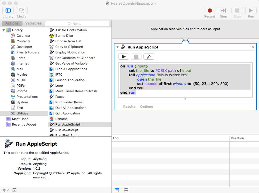

Just to follow up on my earlier suggestion, you can create such an applet in Automator.
  1. Open Automator
  2. Choose "Utilities" > "Run Applescript"
  3. Paste the code below
  4. Adjust the window size as you like
  5. Save the applet
You can drop files on this applet and they should open with the specified size.
Here is the Applescript code:
on run {input}
	set the_file to POSIX path of input
	tell application "Nisus Writer Pro"
		open the_file
		set bounds of first window to {50, 23, 1200, 800}
	end tell
end run
Below is what this looks like in Automator:
