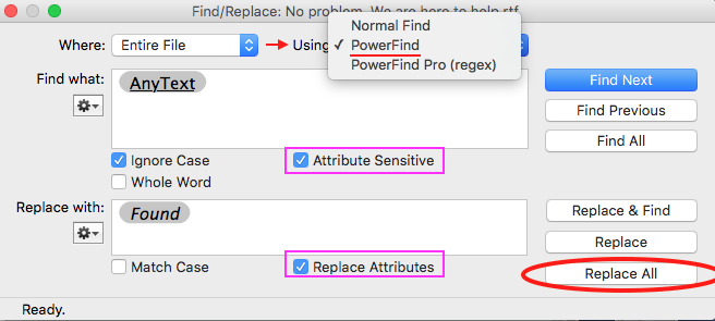

I have tried to Find/Replace all underlined words with italic, but cannot seem to make it happen. Is there an obvious way to do this that I'm missing?

Did you enable “Attribute Sensitive” and “Replace Attributes” in the Find/Replace box?

Using PowerFind Pro, the Find expression is “.+” (without the quotes). Here I have typed in “.+”, selected it and underlined it (Cmd-U). Tick the Ignore Case and Attribute Sensitive checkboxes and untick the Whole Word checkbox. You’ve probably done all this already.
For the Replace expression, type “\0” (without the quotes). But this found text incorporates an underline, although it’s not obvious in the expression. The trick to removing it is to select the “\0”, then Format > Underline > None. Now italicize it (Cmd-I), tick the Replace Attributes checkbox, untick the Match Case checkbox and then Replace All.

The main reason that attribute sensitive searches fail is usually that the find expression contains some unwanted formatting. This typically can happen if you copy something into the find box, or if you type into a find box that was not empty. Check the "Format" menu to see if any unwanted attributes or styles are applied. If necessary choose "Any Attributes" to remove all attributes, and then reapply only the desired ones.
If it still doesn't work, *un*check the "Attribute Sensitive" box and make sure the Find finds something. Then re-check the "Attribute Sensitive" box. If the first works and the second doesn't, the problem is probably an unwanted formatting attribute.

Here is what I do:
1. Underline some text
2. Open up the Find/Replace box using PowerFind
3. Enter “Any Text” bubble in the Find field
4. Select the bubble and assign it the attribute Underline Single
5. Enter “Found” bubble in the Replace field
6. Select “Found” bubble and assign it the attribute Italic
7. While still selected, assign it the attribute Underline Single
8. Repeat step 7
This works perfectly. The text is now in italic, but not underlined. No PowerFind Pro needed. :-)

Ah, now the truth comes out! You have applied the Underline Single attribute twice, which was not evident in your previous posting. So yes, that works.
Others should be aware that it is immaterial whether one uses PowerFind or PowerFind Pro in this situation. The main point is that the Found or \0 expression in the Replace field incorporates a hidden Underline attribute that must be dealt with somehow.
