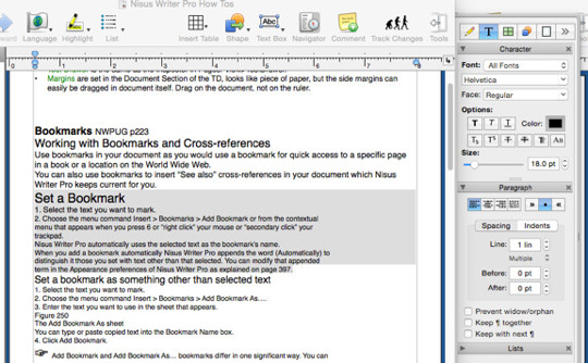

Subject Text Behavior: My goal is to change all the text in a selected group of text to the same size. In a text document, that I'm putting together by cut and paste, when I select a block of text of different sizes, in the Tool Drawer, the text size box gives no indication that text of multiple sizes are selected. Only one size is shown, the largest size selected. In this case 18 pts, but I've also highlighted another section of text with a size of 10pts. With the block selected as indicated below, when I change that size in the text box to 14 pts, the 18 pt text shrinks down to 14, but the 10pt text shrinks to 6 pts.
Text Size Example 2sm.jpg (83.99 KiB) Viewed 7080 times

What you've described above about adjusting font sizes is true, and is the intended behavior. When you use the up/down arrow "stepper" to increment or decrement the font size of the selected text, the adjustment is applied to each font size independently. That is, if you click twice to increment the font size +2 points, then any selected text using a 10 point font size becomes 12 points, and some other text using 6 points becomes 8 points.
To achieve a uniform font size for all selected text, regardless of how many font sizes are in effect, you can do any of the following:
1. Hold down the Command key when you click the font size stepper's up or down arrows.
2. Use the font size slider, ie: drag the slider's knob left or right to adjust the font size.
3. Place the selection inside the font size text field and press the Return or Enter key on your keyboard.
4. Use the main menu Format > Size. That menu also will show you the different font sizes in play.
