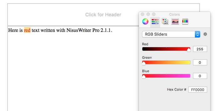

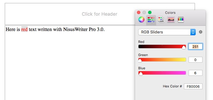

Hello Martin, and thanks for your reply. I made a few experiments and I think this time I can be clearer than before.
Let’s take the red color as an example. I did not mean that Nisus 3 changes the red color of a text originally written in Nisus 2. I just meant that the “red” of Nisus 2 and 3 are different. Below are screenshots of two files, created with Nisus 2 and 3. As you can see, the RGB numbers for "red" are different. In both cases, I applied the red color through Format > Text Color > Red.
This is also confirmed by the RTF codes of the two files. Please look at the other attachment below, which contains the first 5 or 6 lines of RTF codes for each file. Look at the line before the last one in both of them.

Nisus 2.1.1 and 3.0 RTF.txt- (965 Bytes) Downloaded 811 times
- Screen Shot 3.0.jpg (48.99 KiB) Viewed 27063 times
- Screen Shot 2.1.1.jpg (47.92 KiB) Viewed 27063 times
