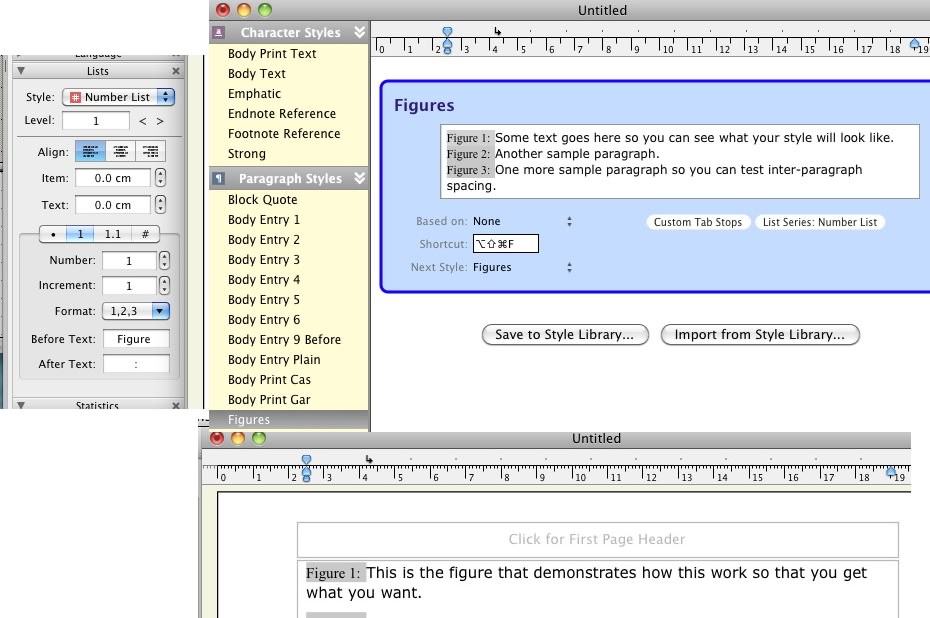

You can achieve what you want through a combination of a new List Style and a Paragraph Style. Here’s how:
1) Create a new List style.
Go to the list palette, click on “Style” and go down to “New List Style”. In the dialog that comes up, you will give it a name, perhaps “Figures” (I named this “Figures 1” but that number is not necessary here, it comes in a moment), base it on “Numbered”, and click “Continued throughout document”.
2) Set the List Style parameters
Now, go back to the List Palette with Figures selected as the style, and set up its parameters. Item = 0 (that is, no first line indent/outdent from margin), Text = 0 (that is, no left indent from the margin), Before Text = type in “Figure” and a space (so there is a letter space between Figure and the number), and After Text = Delete the zero and type in a “:” . Okay, tab out.
Now that gives you a block of text with no indent, but you still have that automatic tab space. So lets APPEAR to get rid of that.
3) Make a Paragraph Style -- Figures 1
Go to the Style Sheet View, go to the Insert menu / New Style / Paragraph Style. Call this “Figures 1”. You’ll need the number because you are going to create at least one and perhaps two more of these.
Then go to the Lists Palette (NOT the lists listing which is part of the Style Sheet -- I always confuse this), click on Style: Figures, and it will change the sample text to your Figures style.
Now -- insert a normal left hand tab marker at a point in the ruler that gives you just a single space between the colon and the first letter.
Give it a keyboard shortcut if you like so you can implement it from the keyboard without having to go to the Styles Palette.
4) Make a Paragraph Styles -- Figures 2 (plus possibly Figures 3)
Still in the Style Sheet View, go AGAIN to the Insert menu / New Style / Paragraph Style. Call this “Figures 2”.
Set it to be “Based on” Figures 1 and all you have to do is set your tab to give you an extra letter spacing. This is to accommodate double digit numbers, i.e. 10 and above. If you are going to end up with more than 99 figures, then you’ll need a third Paragraph Style with a further letter space to accommodate the three digit number.
While these are separate Paragraph Styles, they are still the same List style, so shifting from one Paragraph Style to the next will not interrupt the number sequence.
Now when you type your figure captions, you just apply the Figures 1 (or 2 or 3) Paragraph Style and it formats automatically.
As you can see, this is a workaround and it has the disadvantage of most workarounds -- it can fall over if other parameters change. In this case, if you change fonts the spacing of your tabs might be wrong. For instance, I use Verdana for easy screen visibility, but generally print in Garamond or Caslon, which are much smaller, so the space left by the tab placement in the Figures 1,2 Paragraph Styles would be too wide.
However, you can correct this quickly if you do your font change in the Paragraph Styles. Change the font, shift the tab, and all paragraphs in that style will change accordingly.

Oh good grief, at last I understand what you actually want the result to be, Dan. You’re not asking a question about gum drops. Seems we have suffered a miscommunication here. I got fixated on the gumdrops; maybe it’s the heat here in Melbourne. Sorry.All I really want is to get rid of that indent.
Proper tone restored (although it's 32 C in my office already at 10 am and going higher):

- Figures solution.jpg (97.41 KiB) Viewed 4761 times
