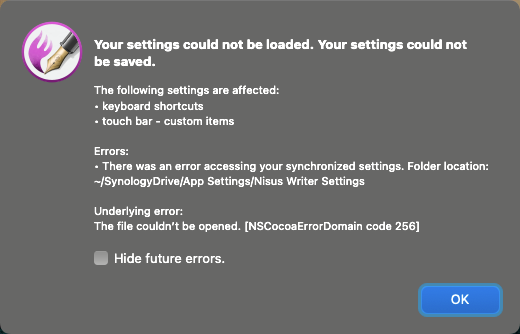

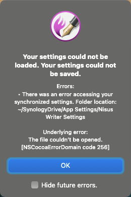

After upgrading to macOS Sequoia (15.0 and 15.0.1), Nisus Pro 3.4 cannot load or save preferences from a synchronized folder. It was working fine before.
The folder is accessible, and I can read all files and subfolders on Finder and QuickLook.
See the attached screenshots of the Nisus error message that appears multiple times.
Has anyone else faced this?

I have the same problem with macOS Tahoe 26.0.1 after a problem with access passwords. I had to change the password from another user, and after this, Nisus 3.4.1 was unable to load preferences and synchronized folder. Yesterday I sent a message to Nisus Support, but for now without any response..

But I will try the steps given for Nisus Writer Express by Martin on nisus.comNisus ForumsFrequently Asked QuestionsNisus Writer Express [How do I reset Nisus Writer Express's sandbox container?]

It worked like a charm!!
As a matter of fact, I had a similar problem many, many years ago, but I didn't remember exactly what I did. So I will save the link to the procedure for the future... I hope I will not have to face the same situation.

But, as I mentioned, deleting the folder User/Library/Container/Nisus Writer Pro solved the problem.
