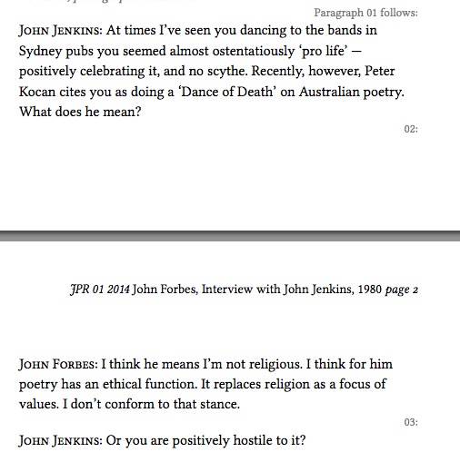

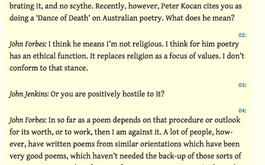

Because quotes from articles can't be referenced by the page number of the article they came from -- there are no "pages" as such in HTML files -- I provide paragraph numbers for that purpose. But when I convert the HTML file to an RTF file in Nisus, and then export the edited file as a PDF, the paragraph numbers sometimes occur just before a page break, thus losing their connection to the following paragraph.
I have tried clicking the "Keep with following" box in the Paragraph Tool Drawer in the hope of solving that problem, but when a paragraph number is highlighted, those boxes become invisible and un-choosable. Perhaps this is because the paragraph number is formatted as range right, 9 point, grey, so as to be relatively unobtrusive, and the following paragraph is formatted range left, 11 point and black.
Is there a solution to this problem?
I have InDesign 6.0 and Adobe Acrobat Pro, both of which can output PDF files, but each offers a workflow path filled with complications and opportunities for errors. Nisus seems simple and useful -- except for this problem.
I attach screenshots of the PDF file showing the problem, and the original HTML file, which doesn't show the problem.
